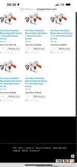

Im installing a kill switch lanyard and was wanting verification on the kill switch being normally closed.

18 is kill switch, is it normally open or normally closed, i think its closed but i was hoping to confirm before i drop 150 and they make both, normally open normally closed. Im pretty sure its normally closed

I believe it’s normally closed is what i think i see in electrical schematic, on some kill switch lanyards it matters, others will work on either type switch.
Yes the switch is in the normally closed
Position and when coil is energized then it will switch the circuit to power
