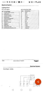

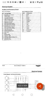

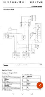

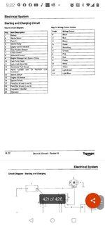

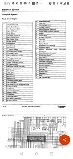

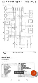

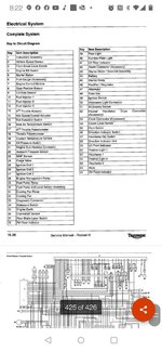

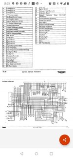

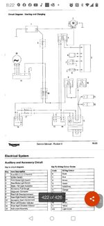

Last 2 page's should tell you something, poke around with the probe some more with the key on, hit the start button, you getting any power to the starter motor main positive, you getting any power at the starter relay, find out where you do have power and go from there, oh I guess the manual can't be shared look at idk signature he has a manual in there, if you don't have one already, good luck

If you have a stock 05 you may have an ignition barrel issue. The headlights are powered through the ignition barrel (why everyone in the early years bought the EB Bypass kit). The lights aren't coming on likely due to the wires coming loose in the ignition switch barrel. The starter relay disrupts the power to the headlights when you mash the starter button on the bike. Check out the schematic in IDK's manual post and you can trace the wires out. Pull your ignition switch and see what wires (if any) are loose.
