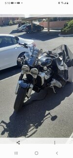

Hey Frosty. I think alot of the metal is on the upper screen, no?
not really, the metal section bolts to the lower screen with the upper plastic attached to the top of the metal section, so the lower screen is taking the weight. If the metal piece was lower on bottom screen that would have helped take some of the stress off, but at the same time, if your doing steady highway speed, without any extra wind, you are now adding more down force on the lower plastic, and if you have winds to contend with as well, then your going to have a fluctuating pressure with the gusts coming and going. That bottom windscreen is taking a lot of force, possible fixes could be going to a Lexan plastic, or going with a slightly thicker plastic with metal inserts for the screws to go through, re-design the bracket out of a lighter material, such as shredded carbon fiber in a pressure mold, Aluminum, Plastic, many possibilities
OK, hard to tell since its gone. Isn't some metal attached to the top screen? Look at this old pic.
OK, hard to remember since it's gone. Looks like from below pic some metal attached to upper shield, huh?

That's it! So much weight up there. I'm sure if you ride like grandma the screen would be fine. But having a rocket no way.

Don't know if you read my idea why my shield broke, but think it was the spacers,very hard, I replaced the softer black rubber ones with that crumbled.
