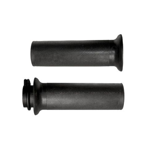

Went to take it for a run, and the throttle cable hook on the grip broke
But what was lucky was that it broke in the garage, and I had time to get a replacement before dyno day.
I've heard of heated grip throttle cable hooks breaking on people a few times. After 15 years, now it's my turn.
Good few folks recommended Oxford heated grips, but when I found that they still need the Triumph tube to go inside the grip (the thing what the throttle cables hook into), I didn't see the point. Still gonna be a Triumph throttle cable hook.
Anyway couldn't find a Triumph heated grip, so just got a normal one.
Turns out they don't even have Triumph written on them anymore, the official OEM part is actually this exact set, if anyone is looking for "Triumph" grips;
