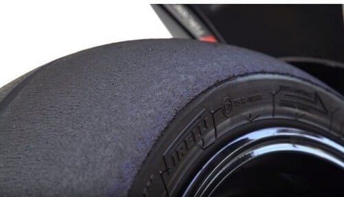

Recently, I went down super unexpectedly (see video link in post below) while riding in fairly good conditions and now I'm on a bit of a mission to understand what happened. In hindsight, I think some remaining morning dew, on what appeared to be dry pavement, on top of some residual diesel, or oil, in a corner was the primary thing that took me down. But, a thought that I've always had about tire break-in keeps coming back to me, as both my tires only had about 150 miles on them.
So, we're supposed to take it easy for 100 miles , or so, in order to wear off the smooth finish on new tires, right? OK, so now the middle of the tire is good and broken in, but once you start leaning her over the further you go the more you keep getting onto "virgin" rubber that still has not been scuffed- right? And, if you look at your tires you can definitely feel the difference between the main riding area and your chicken strips, however small or large they may be (probably given your geography).
So, today, I took a vibrating sander to those chicken strips and in about three minutes I had removed the sheen from that area of the tire. Now, I didn't do this, but if you were to dip your finder in oil and smear it against the chicken strip (pre-sanded) and the rest of the tire, I think you'd find that the chicken strip would feel more greasy and slick than the other area, which would absorb (sponge up and , because rough, have more rough surface area) some of that oil. This just seems to make common sense to me.
Sanding is not "mainstream." One site just considered it a "waste of time," but after riding today I can say that I sensed a more positive feel as I leaned further and further into the corners (post crash). Placebo effect? Well, maybe, possibly..... What do you think?
