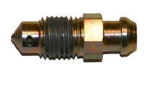

Another useful accessory are auto bleed one way bleeder valves for our brake systems.
Speed Bleeder for Triumph Motorcycles $6.99 each - 4 for $27.96 at NewBonneville

I have the speed bleeders sitting on the bench with brake fluid, just waiting for me to move the brake line
So are your Speed Bleeders stainless or otherwise?

Here are the speed bleeders. Ball is SS, didn’t look at what the body is made of.
