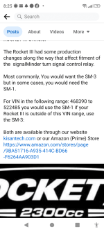

Found this but my vin seems to be in the use SM1 range.
