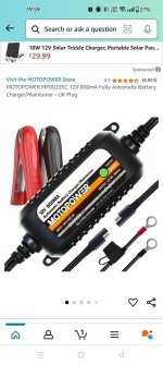

Have a charger similar to this one
the #1 reason i go with TRIED and TRUE / Quality brands like Noco vs some amazon or eBay special or the brand "battery tender" is that when these POS devices fail, they send too much unregulated voltage to the battery and KILL THEM. quality stuff like noco fail in a OPEN circuit. I bet you 10 bucks that the charger you have has failed. i would not be using it. It may send out voltage to charge, but the regulator to STOP the charging seems to not be working right.
