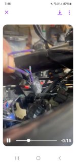

Very similar fault from a guy here in NZ....the loom from gauges that goes into main loom...he cut that open & found a broken wire where one purple wire went into 2 purple wires.
thanks i had forgot about that purple wire conection
would you happen to have a link to that thread that contained a good picture?

Here's a pic from my messanger video he sent me, not sure where he posted it though. I think the 2 purple wires came from gauges.
