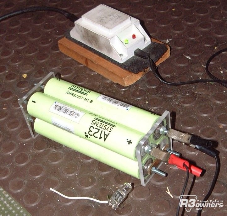

It's not an ISSUE per se. I use Lithiums on both bikes. One (a commercial brand) is the temp affected chemistry. The other (I made myself so know exactly what is inside) is not.
The one made with A123Systems LiFePO4 cells works - the other well it works fine in Spain, it is a bit of a PITA at my mums if it's chilly.

I know of VERY few commercial "Lithium" starter batteries that openly state they use A123Systems cells.
LiFePO4 chemistry is the acceptable base line - If it just says "Lithium-Ion" it most probably is NOT baseline.
But A123 cells go the extra mile and are designed to "dump" power fast.
This said if you live where it seldom drops below 10°C where your bike sleeps - you will not have an issue.
A123 cells are NOT cheap.
You would be best off (imo) with a 4S4P battery. 16 cells at about 10Euros each that's before you solder, add a BMS and make it look pretty and short-proof. I would now simply ask i-tecc to make me one. 240Euros.
A 4S3P would do the job - and a 2S4P might on a good day. But if you are going that small - leave a lead acid in and carry a 4S1P booster in you jacket pocket.
