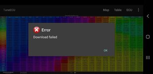

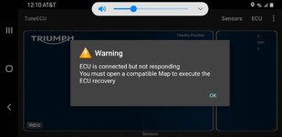

Well I guess I hosed my bike, everything was going fine connected via blue tooth, took 20 min to reprogram, then got download failed, tried it twice, now dash comes on, no neutral light, no gauge indicators , coolant, TPMS, fuel level, won't even start,etc. Now what any idea's? Now LX won't even connect.
It is not that much of a problem and will just take some time.
Open the stock map.
Try to get the LX connected.
Then follow the Tune-ECU orders.
Hey Penner
Now sure how to open stock map but I did get to a MAP function that said do you wish for full recovery, checked yes and it says reprograming and will take 56 min.
Does that sound right?
If u have a weak battery and u r not connected to a charger u r going to have problems.

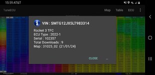

I did the full recovery and now everything is back to normal starts OK in everything and I may even have the new map downloaded I'm not sure cause I cannot find a option to read the map thats in there now I did tap the information option on couple of screens and got this

Translation, you can’t read the map from the ecu. What map were you downloading when it crashed? Anyway, turn everything off, open TuneECU, open Penner’s map for your model in the Map tab. Plug in the LX. Turn the ignition to on. Under the ECU tab, connect, then load map. Hopefully it won’t crash again but you now know what to do. (First, remove headlight fuse and put battery on a tender). Btw, I downloaded maps to my T120 maybe 4 times and it always crashed. But it always finished the recovery.
