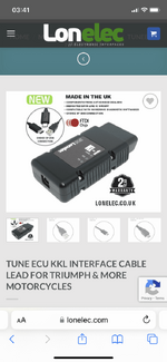

Ok I give it a go. When I get the cable do I need to download some package
You can either pay for the Android version of TuneECU to use on Android phone or tablet, or use the legacy Windows version for free with a laptop (I can email it to you)
