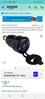

I think my problem is every USB plus I tried on amazon was just massive.. do you have one you can recommend?
Yup. This...
