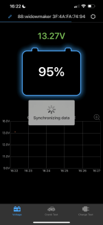

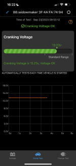

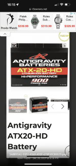

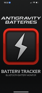

This xmas will be 4 years on my antigravity battery. Never an issue, has set unused for over a year, the other 3 in use 9 months, cold no problem, cranking never an issue. Knowing what its doing at all times, priceless. The best battery i have ever purchased! This is my experience with an antigravity battery, all battery’s like anything else are not the same, this battery has done as advertised.
