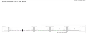

here you go. it looks pretty straight, Fuel sensor + connectors + Engine ECU
Now your sensor has been changed, maybe its not installed properly?
