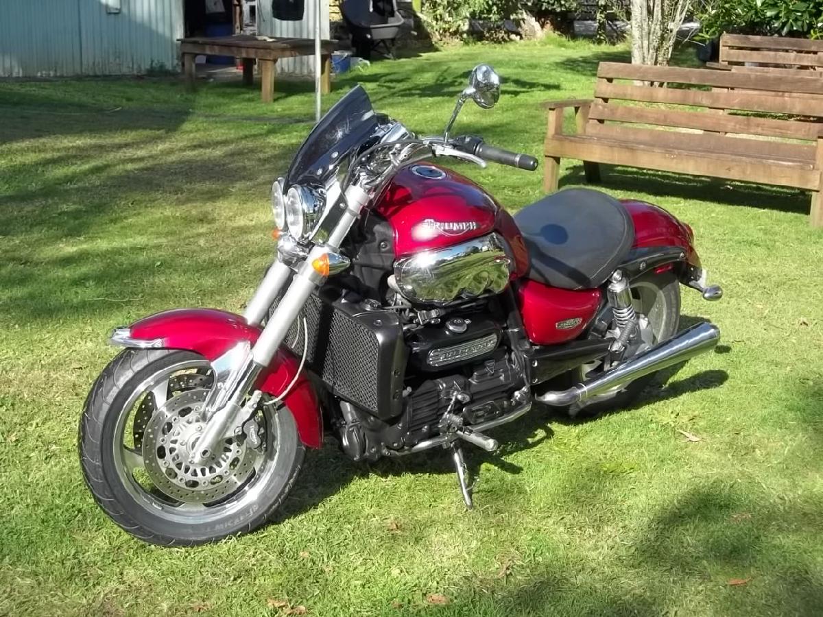

Have a look at my facebook page www.facebook.com/vikingexhaust I build various systems for the Rocket.

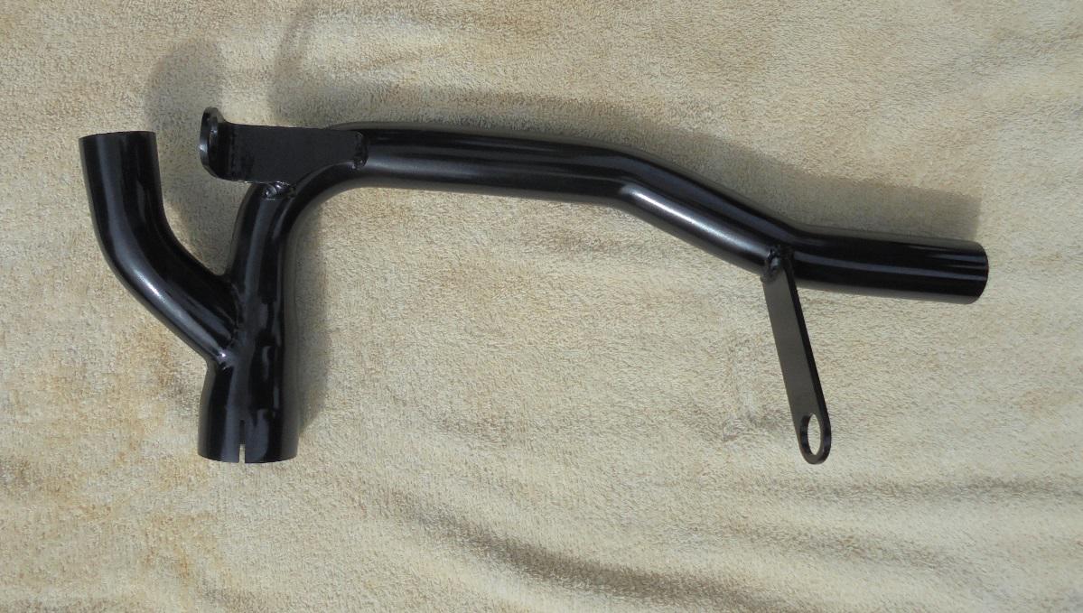

One part that is in production now if you are considering the Roadster system is a free flowing cross over pipe, this will slide straight onto your stock Classic header and use the stock Roadster mufflers, or the Roadster TORS. All model headers are the same, it's just the rear end components that are different.
I have built a twin muffler system for my own bike, which I am going to get into production "when I get there!"
I can set this up so that the mufflers are running parallel to the ground so as to clear your bags.
Drop me an E-mail to paul@vikingexhaust.com

What difference does using your crossover pipe have between the stock one? Is yours a direct bolt on to my classic - or is it set up to bolt on a roadster and it's something I will have to modify? I know the roadster's cat is in the stock silencers - so by using the TORS silencers - that should make some difference in performance and be very close to what I have now. And I wouldn't want them to be too close to the ground...or they will scrape on corners really bad in the twisties....but maybe lowering them a tiny bit wouldn't hurt.

The parameters of fitting any lower silencer are A) the lower edge of your hard bags, and B) cornering clearance.
You could easily use my cross over pipe which as I say is more free flowing than the stock unit, combined with a pair of Roadster TORS.
The L/H one wouldn't be a problem as this L/H unit has a 90° bend at the inlet where it attaches to the cross over pipe, (see the top photo above) so you could easily rotate that downwards so as to clear your hard bags, what cornering clearance you would have, I don't know, but it is the bags that are going to determine that.
Once you have positioned that, you would simply make a mounting bracket to suit.
The R/H Roadster TOR/Stock unit is slightly different as the inlet tube into this Silencer is at an angle, so rotating it in the same manner as the left will lower it a little, but will more so, just "rotate" it. Also it will swing outwards as you do so.
The only way to set this right would be to cut the inlet tube, position this R/H Silencer, then re-attach the tube.
As you have already made up the L/H mounting bracket, I would make a mirror image one for the R/H side. This way you can mount/bolt up the R/H Silencer then match the position/joint of the inlet tube.
Give some thought to exactly where you make the cut.
Do remember that the Stock Roadster units are quite large in diameter, I haven't seen or measured the Roadster TORS so am not sure of the Major diameter of these.
As you obviously have Engineering skills, making mounting brackets won't be too difficult for you.
Thinking hard as to how to make this happen with out me spending a lot of time ($$$) or you spending a lot $$$, a thought I've just had, what if I build you the complete cross over pipe, but not attach the R/H Silencer joint tube, (or R/H mounting bracket as that is for the Roadster not the Classic) and not machine the entry hole into the pipe ?
This way you could fit the crossover pipe, mount both Silencers on the brackets that you have made, slide my R/H inlet tube into your R/H Silencer, then "stick 'em together"
Also, this way you wouldn't have to modify the Tors unit.
Send me an E-mail to paul@vikingexhaust.com for component costing, which would be less than the retail cost of the completed unit as I would not be putting as much time into it, or finish coating it. Shipping to you would be about US$80.00
