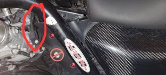

I have always had a hickuo or 2 in 2nd around higher revs but again when I was giving it the beans.... like ONE or two max not predicable.
Progress to now that I have the new pipes and deCAT nothing changed. Then I put the ramair intake on and did a 12 minute tune as per instructions. I also removed the secondary butterflys. Now the hiccup issue happens a lot maybe 5 to 10 times during all rpm range in the entire duration of a full lull in 2nd gear and is not dependent on load or throttle, it can and does happen at just cruising to next to idle revs. When I say hiccup I mean a misfire. Never in any other gear.
I changed to overhead coils and new plugs ngk 7ae-9 gapped correctly 0.034-0.035. Old plugs were also fine btw, but it did not change that issue but did smooth out how the engine ran maybe!
I am still on the original tune and I suspect that once I flash in a proper tune that hickup issue will go away?
EDIT; I JUST was finally able to reflash the ECU with a proper tune and the issue has gotten WORSE... wth? 2nd gear is almost completely full of misfires "stumbles" "hiccups" whatever you call them.
IT DOES NOT do this in any other gear in any rpm range at any throttle% ONLY in 2nd gear. The tune feels much smoother btw.
New TPS + adjustment set to 0.68v (instead of 0.62v) with IACV fully open will resolve it most likely. This adjustment was the issue on many roadsters, there was a wave of bikes that would just stall because of it and cough/backfire through the intake in 2nd gear at times.
the guy that advised you about the nuetral switch is right on it is a good idea to clean that.
with the nuetral switch if the ecu does not read 2nd gear then the ecu will substitute nuetral and it runs for $hit.

Primary TPS on the parts fiche, #2 here, the new ones have a blue inside, they last a long time usually, much longer than the older ones:
This is on the end of the TBs by your left knee, NOT the one on the radiator side of the TBs (that's the secondary and can be completely ignored with removed secondary plates).
TuneECU has a TPS adjustment feature. When following the instructions for it, substitute 0.68 for the part where it says to get to 0.60-0.62. I've tried this on multiple R3s now and they always run better with .68 instead of .60-.62.
This voltage tells the ECU you are at true 0% throttle. When it's set to 0.68 instead of 0.6, the slightest motion of the throttle now registers to the ECU. With 0.6 setting, there is slop between physically closed throttle and just slightly open where the ECU still receives a "fully closed" signal. This mismatch between physical open amount and ECU signal screws up fueling and ignition timing.
With a failing sensor, it will stick in places at a certain voltage. So, for example, if you go to 50% throttle but the sensor only sends a 15% throttle because it's a bad sensor, fueling/ignition will be completely wrong for the amount of air being ingested and the bike will hesitate/buck/cough etc.

I'm assuming this was the neutral switch? I just cleaned it with some scotch bright pad and brake cleaner off the bike and the plunger.
20230818_145143.jpg 20230818_145836.jpg 20230818_145827.jpg 20230818_145158.jpg
