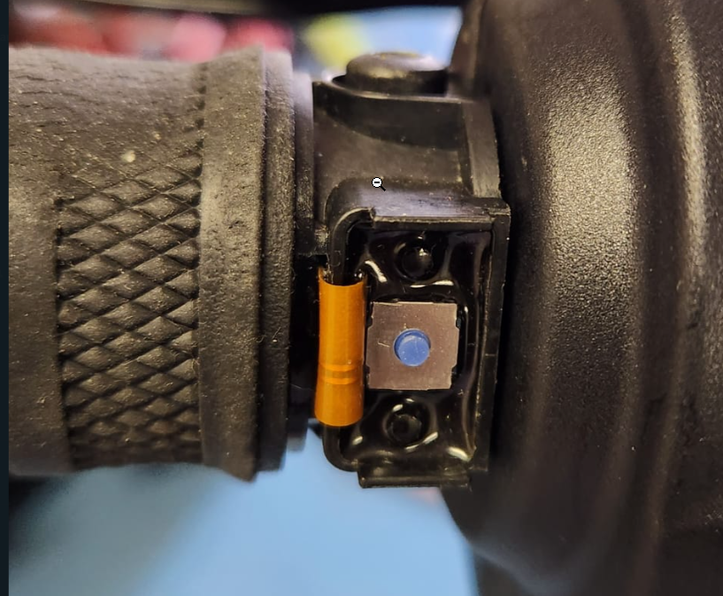

As established, moisture kills everything, my heated grips after 1.2 years of use and seeing rain.summer,regular wash, cold and maybe dirt. The button started acting and stopped working and will only work randomly.
so I opened it up and used the Electric contact cleaner and lubed the heck out of it,
Air blast afterwards you are done, let it dry.
You are golden when you feel the nice click of the button like its brand new.

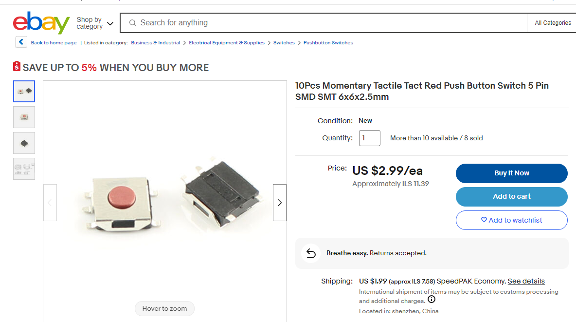

yes, its part of hand grip plus it soldered and its a cheap switch.
$3 of 10 of them and its not just triumph, i seen this cheap stuff on all latest superbikes like s1000rr bmw etc.
