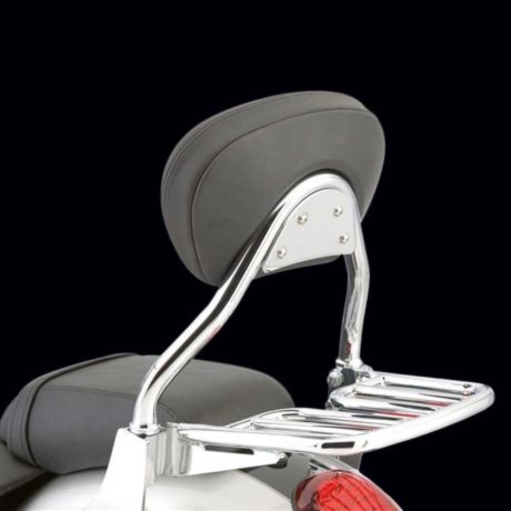

    Good day All,
    Looking for a luggage rack for the R3T.
    Just the rack itself and it doesn’t have to be in perfect condition.
    My back rest is off a 2017 R3T.. I’m assuming they are all pretty much interchangeable.
    Thank you

    Search and keep an eye on eBay. Note that the tack for the thunderbird is the same. That is how I found mine.

    Which Thunderbird version did you get and use @Jay, Part number please?
    There are a few to get confused over and the Thunderbird LT 2015/16 version from the Quick Detach Sissy Bar does not get a mention at all in the Fowlers UK Triumph parts fiche - which is weird. I thought they were the same as the 'Special Edition' Thunderbird but that was in fact a 2010/11 only model with a fixed rack and different part numbers. It gets confusing.
    Note also that different model Thunderbirds have different tire/wheel combinations and sizes and I am pretty sure the TB LT is a different wheel size and likely frame to the other TBs.
    A Cycle World explanation:
    2014 Triumph Thunderbird Commander- First Ride Review- Photos- Specs
    A9758068 R3T
    A2306380 R3T & Thunderbird Commander/LC
    A9758189 Thunderbird Commander/LC
    These MAY match:
    A9750570 Replaces A9750517 Thunderbird (1600/1700)
    T2305992 THUNDERBIRD (1600/1700) special-edition-only 2010/2011
    The R3T rack was actually known under two part numbers.
    Luggage Rack Kit - Triumph ROCKET III TOURING | Triumph ROCKET III TOURING Luggage Rack Kit supplied next day (UK only) by Fowlers Parts
    1 Luggage Rack Kit A9758068
    NO LONGER AVAILABLE
    $201.69 inc. VAT (£113.00) -
    2 Luggage Rack A2306380
    THIS PART IS NOW OBSOLETE
    NO LONGER AVAILABLE
    $215.33 inc. VAT (£120.65
    Sissy Bar, Q/R, Passenger, Kit - Triumph ROCKET III TOURING | Triumph ROCKET III TOURING Sissy Bar, Q/R, Passenger, Kit supplied next day (UK only) by Fowlers Parts
    Bikes that use part number A9750325
    Assembly name
    Triumph, ROCKET III TOURING , Sissy Bar, Q/R, Passenger, Kit
    And then the other versions (some to be confirmed as exact same) with same and different part numbers but which have same appearance and some associated part cross-fitment. The connections are sometimes buried as some out of production parts and/or accessory/'special package only' versions get deleted from the model search functions and have to be found via back doors.
    Thunderbird rack versions:
    Another two part numbers but note identical number to the R3T version above.
    THUNDERBIRD Commander
    Luggage Rack Kit
    1 A9758189 LUGGAGE RACK KIT
    - unavailable -
    2 A2306380 LUGGAGE RACK
    - unavailable
    [​IMG]
    Chrome Luggage Rack - Triumph THUNDERBIRD (1600/1700) | Triumph THUNDERBIRD (1600/1700) Chrome Luggage Rack supplied next day (UK only) by Fowlers Parts
    Chrome Luggage Rack
    1 CHROME LUGGAGE RACK A9750570 Replaces A9750517
    2 Instructions A9900417 NO LONGER AVAILABLE
    3 Sissy Bar QD A9750516 (To install luggage rack A9750517)
    1-3 IN STOCK $571.14 inc. VAT(£320.00)
    [​IMG]
    Bikes that use part number A9750517
    Assembly name
    Triumph, THUNDERBIRD (1600/1700), Chrome Luggage Rack
    Triumph, THUNDERBIRD STORM, Chrome Luggage Rack
    Sissy Bar & Rack - Special Edition Only - Triumph THUNDERBIRD (1600/1700) | Triumph THUNDERBIRD (1600/1700) Sissy Bar & Rack - Special Edition Only supplied next day (UK only) by Fowlers Parts
    9 Rack, Luggage T2305992
    [​IMG]
