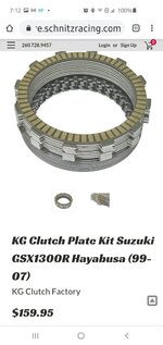

Is this the kit?

i ordered the suzuki kit came with springs and gasket which i gave to tuner as all i needed was the plates and fibers. The one you posted is the kings of grudge drag racing set, I would order the oem kit if youre not racing it, the kit i bought still uses the judder springs therefore it has the smaller lip first in fiber. I bet the kg set you pictured does away with the judder stuff for racing. The kit I bought is strait forward and installs like yours comes out, the kit has 2 plates that are thicker than the rest and they should go in the middle of the pack as you load basket. Not together ofcourse but 4th fiber in then fatter steel than 5th fiber and the other fatter steel than fill it out. so really your choice either judder system as oem or the kg kit and no more judder stuff. Some run now without judder no big deal but if youre racing the judder springs and small fiber are out and thats ok. It will shift fine, just make sure that clutch is adjusted correctly at all times or neutral and parts (lifter, lifter piece) will be affected. I am ordering the kg kit when this pack is toast as i try hard. the oem suzuki kit for busa is a great kit as ive raced on it and it is holding up well. Tearing apart bike now and will indpect to make sure im correct but feels great.
