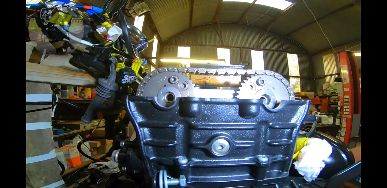

Here you go Warp hope this helps the new sprocket is attached to the camshaft

A final thought regarding changing the cam chain, good standard practice is to also replace the gears as they wear together.
I changed as a set there was wear on the intake sprocket for some reason on the face and outer edge
