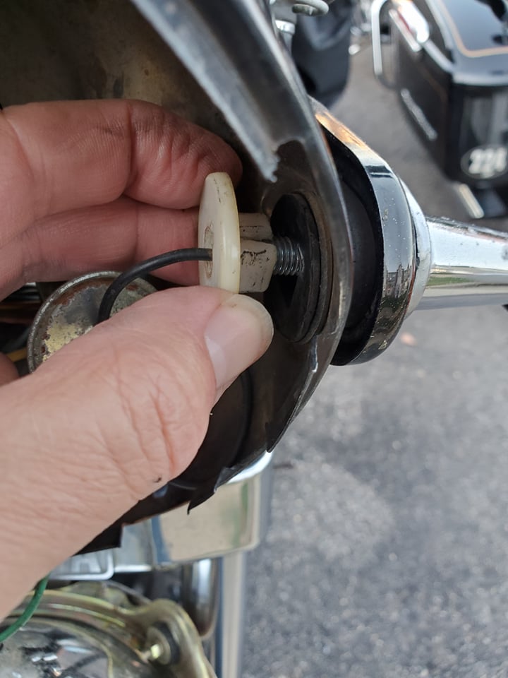

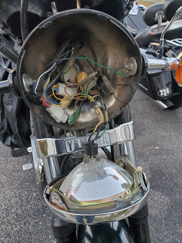

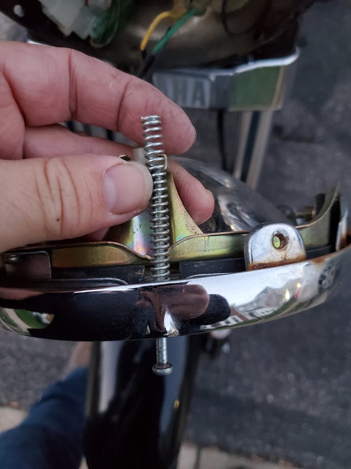

Boog that missing screw is what holds the headlight assembly on. Use a flat blade driver between the shell and bezel where the screw is missing and pop the headlight out. That 3 foot screw adjusts the headlight aim side to side and is part of the bezel assembly. With that screw missing just pop the bezel off and the headlight is mounted to it. The blinkers are mounted inside the headlight shell with a nut and the washer is also the blinker ground line. There's only a single power line to the blinker from the flasher unit. You'll need to replace that missing screw upon reassembly if you don't want the headlight disassembling itself at the most inopportune time. Use a countersunk screw. If you change out the blinkers with LED's make sure to put an in-line resistor in or the flasher unit will blink at an extremely high rate.
