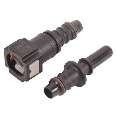

I just ordered the connectors off eBay here for about $11. Should be here in about a week. Not shipping from China.

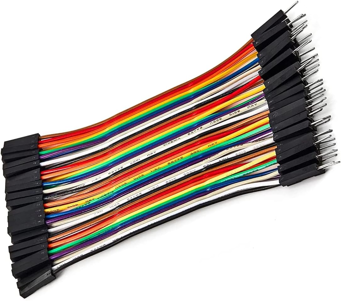

Here's my $1.99 solution, including shipping....
I'll cut two in half and splice in whatever length of wire I need to make the jumpers.
So, the cable extension is $44 with shipping. Seems like a lot for what it does- extends two wires.

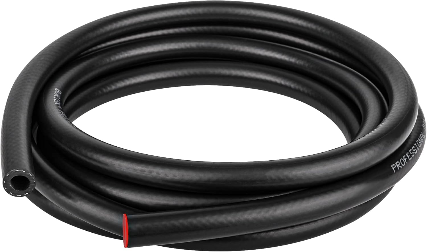

The manual calls for two special tools. T3880001 to extend the fuel line ($287.53) and T3880123 to extend the electrical connection to the fuel tank/pump ($31.14).
But, on the Hermy's website for both parts it says these are not compatible with your bike. WTF?
The $$$ fuel line extension has a connection for a pressure gauge, which is not needed for this procedure- you just need the extension so you can get the tank out of the way. My question to the few who have pulled the tank, like @Tal, is this..... is that connection somewhat standard where you could make the part, if you just knew what to get?

You could just buy a similar fitting from Ali Express and crimp it on the the hose easy enough but the mechanic at the dealers said if there was a problem down the line then my warranty would be void.....
