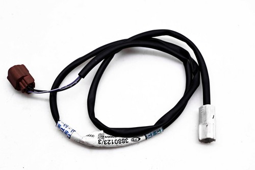

The cable you have from that article looks wrong, even though they mention the same part number. There should not be those two small leads. There are other photos of the T3880123 cable that look like this...
Just two wires- I'm debating just jumping them.
Now, I do not want to take chances by jumping the fuel pump wires etc while working with fuel itself, a little spark can cause headaches instantly or down the road to fuel pump itself so I ordered the proper cable and its $33usd from triumph, I gave them the number T3880123 and whatever comes in I am happy. I can make cable and solder wires anytime but the cost of those oem connectors from china+ shipping will cost almost same as oem cable. Had that extension cable cost 100+usd i would have made copy of OEM cable by myself, those triumph harness connectors are also being used on several cars worldwide thus easier to find.

The cable is being used on heaps on other triumph bikes so I guess we will find out which cable is correct, the one in your photo or one in youtube video plus photo i found on internet.
