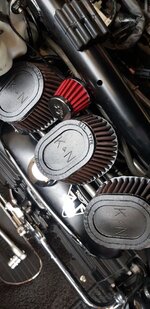

I used a small k&n for the sensor & it just sits inbetween 1 & 2. Didn't need to extend the wires. 🚀

The ait sensor comes off main wiring harness, the map sensor is on the aux harness with fuel injectors tps sensors, idle stepper and oil sensor, the ait sensor reaching to pods with no extension is interestin, they have same plug. anyway interesting
