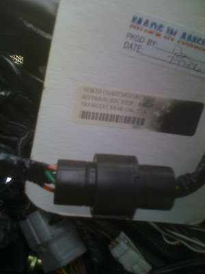

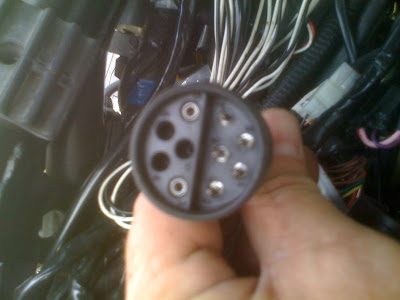

Ok fellas So, here it is... Decided to tackle the ignition connector today. The sure-seal came in the mail yesterday. Looks like a great product the body of the connector is high temp rubber and both sides have both male and female pins. The pin diameter is way-larger that what was in the stock connector. This is good.

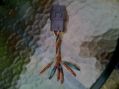

After peeling back some of the electrical tape the triumph tech used to hide his shoddy work, I found they had overheated the wires with a heat gun trying to shrink the environmental splices they used to replace the original connector. (I am assuming this was part of the upgrade kit. I had this done A year ago last june). The wires were all bird-caged and the insulation was completely broken down and gummy.
So the first part of the operation was to cut away all the bad wire and remove the harness. Fortunately I left a lot of extra wire when I relocated the ignition.

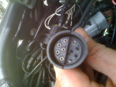

Next was the tedious part of soldering all the connector pins onto the wires because did not want to pay for the crimping tool. Next I inserted all the pins into the new connector being careful to match them on both sides of the connection.
All was left was to splice the connector back into the harness using environmental splices I purchased at Home Depot. I was able to do this without overheating or damaging any wires. Imagine that?

This is the old connector with some of the damaged wiring.
New Connector:
Finished product:
Working great now, Starts when I push the button. Also noticed no static noise from the stereo anymore.
