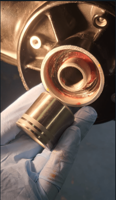

Listed on the maintenance schedule as part of the 10K service is lubing the "rear wheel roller bearing (left hand side outer)". Has anyone done that, or is there a YouTube video or any other resource, other than a shop manual, readily available that shows how to do that?
pretty easy, get the right grease ( good quality), get the oil seal in case you break it, get the torque wrench, socket, center stand, wheel removal socket,
Now I see them, thanks. What do you make of this that I found in the service manual? Are they talking about a different item?
this is not rear needle roller bearing, this is about shaft connecting differential/bevel box and the engine
