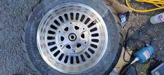

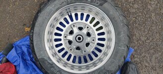

I polished the back rim today, started about 2 in the afternoon and finished about 5:30, - 1 hr break in-between, so it took me 2.5 hrs just to polish the 1 wheel not counting removing it, that took about 2 hrs cause I stripped 1 of the hex head bolt for the brake disk to get it off, luckily it was out enough to cut the edges off 2 sides and get a 12mm wrench on it, now I have to find a new bolt, hope they aren't discontinued, 1 website said they are, and another says they are available, but that doesn't always mean they are available I found out with the windscreen lock, discontinued can't get it anywhere, not even a used one.
Well I think Gords aluminum polish did fairly good, not perfect, it still has some faint spots I'm sure I could have gotten out with some wet sand paper, maybe start with 1000 grit and work down to 6000, would probably make it perfect, but I was done for the day, maybe I'll stop tonight and get some, I didn't have any, but here's what it looks like after 2 to 3 hrs.
A very big difference, I used these buffing Wheels I got on Amazon, Car Buffers and Polishers Kit for Drill, 14Pcs Drill Polishing Wheel Foam Ball Buffing Pads Sponge Ball for Automotive Car Wheels Hub Care, Metal, Plastic, Ceramic and Glass Car Buffers and Polishers Kit for Drill, 14Pcs Drill Polishing Wheel Foam Ball Buffing Pads Sponge Ball for Automotive Car Wheels Hub Care, Metal, Plastic, Ceramic and Glass worked very good, perfect size, probably should have used them from the beginning, I used a cordless drill driver with them, I started with the 0000 steel wool, wet the wheel with the soaked steel wool, let it soak for a few minutes, and rub the heavy corrosion off. Then clean it with the shop towels after it dries, at least that's what I did, a few times then I used the buffing Wheels, I even used a Dremel type tool to get in the holes. GL hope it lasts a long long time 🤣

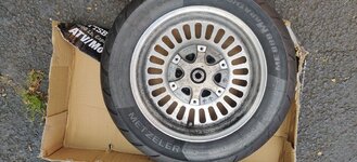

I gave up polishing after about 15 minutes of using the very fine steel wool that came with the Gord's polish. I'm lazy. The rear wheel now looks clean but certainly does not shine like yours. Seeing what good looking results your hard work produced might motivate me to dedicate lots more time, effort and tools the next time I change the tire. :thumbsup:

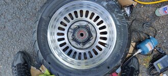

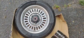

I just did Day 2 of polishing the back wheel, I wet sanded it with 1000 then 3000, then buffing Wheel with the Gords seems to work better if you let it soak for a few minutes then continue buffing, then wipe off with red shop rags then finish with microfiber towel, I also replaced pads and fluid in the back break, ordered the bolt from bike bandit, local shop online said it was discontinued, how can they do that, it's only 13 year's old, I don't like that, I'm finding that too much already.
Oh I have the Mobil delvac grease too for the spline and any parts I greased, couldn't find moly grease in advance auto, felt pretty good tonight, even with the missing break disk bolt ⚡😁 hey it's got 5 others right 😁

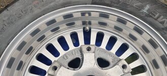

Not very many spots on the rim, maybe a couple really faint spots, but I'm very happy, I tried the mothers, did nothing, I got about half a bottle of Gords left, it should be enough to do the front, but I'm getting more of that stuff, I think it did a great job!!! Just what I wanted!!! I'm very happy, I still have to clean the holes but I think a good wash will do that, I didn't spend too much time on that, I already did the front brakes and fluid and it should be easier to get off and on, it worked out just lowering the jack to put the tire on, very slowly, checking that it didn't bind on the way down. Did you do the front yet??? Any pointers!!!😁⚡💤 Have a great day!!!👍😊
