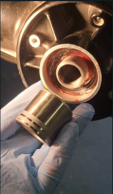

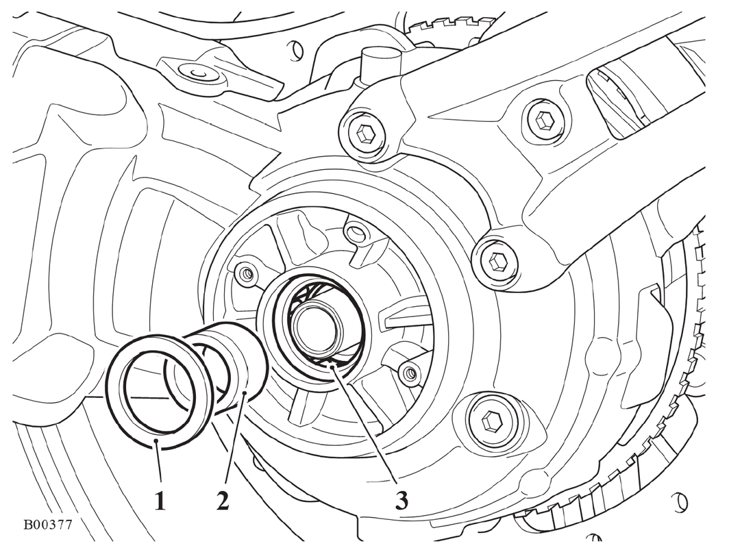

Aren't the needle bearings on the other side of that seal? I thought you had to remove the wheel shaft to be able to get grease to them.
in the photo the red grease is filled up so you can see needle bearing. Part 2 from photo below is whats in my hand in photo above.
Ok, so the shaft doesn't have to come out. Looks like the wheel is still on in the diagram. How hard was it fishing out that spacer without buggering up the seal?
edit...That seems easy enough to check there if it just pulls out. I guess it needs jacked up so there is no load on the rear wheel assembly.

Spacer comes right out

No shaft like we're used to- the wheel bolts on like a car tire :)
