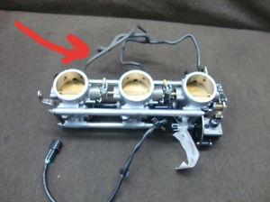

P1105 Map Sensor Pipe Fault
Just trying to clarify, the three hoses to each of the throttle bodies are 4mm ID and 250 mm in length. What is the length and ID of the tube going to the Map sensor?
About 175mm long. 2.5mm wall thickness. One end is flared; 5.5mm internal diameter one end, 3.5mm the other.
