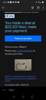

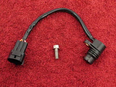

Looks like this sensor the part that goes into the engine, but I think the connection on yours is in a triangle shape, maybe worth it to try it if it doesn't work try to resell it
Different part number so it's definitely not going to be exact, I think the wire colors are the same???

in the lower motor at rear about 1 to 2 inches behind the kickstand is the vss vehicle speed sensor.
i doubt that is your problem but u might pull it just in case it has metal on it. it is magnetic
i have never had mine out just wipe it off and put it back. check the wires.

06 maybe different but same part # as 08 so I guess it's the same, mine wasn't magnetic, but I think the crank position sensor is??? Maybe because mine wasn't any good??
Never had mine off but i deal with the vss al the time the magnetic pluses is what makes the current (aprx 1 volt per 1 mile per hour) and that movement is what makes the vss go bad. it loosens in the unit or breaks the wire. it happens all the time on cry products. reading on scanner will jump from 0 revolutions' to 100 the ecu does not like this.
