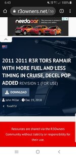

Howdy guys, got a little Gremlin issue.
Had the bike dynoed the other day & it's still there!
What happens is the bike sort of cuts out for a split second randomly. More so when in lower gears or lower revs. On full throttle no problems.
I've changed a few maps & settled for one out of the resources page (photo) & as recommended set tps @ 0.64 & iscv @ 0.76
It dose run good & better than the dyno tune that was loaded, but that little bugger is still there.
Could it be a dirty 02 sensor? Maybe a bad earth?
Thoughts appreciated, cheers guys ✌

This is the bike I built...2016 engine with 2010 ecu & gauges. It seemed to run best with the stock 20352 tune but a bit lean, still had the blip but only more so at idle or first gear.
I run the k&n filters & viking single free flow exhaust with standard headers.
