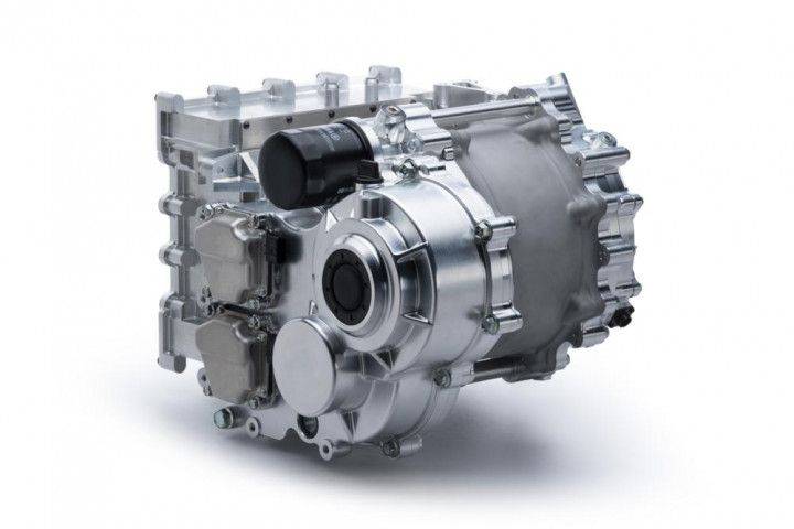

With power figures ranging between 48PS and 272PS, these motors can be used for automobiles and other mobility solutions. But the highlight is the brand’s 476PS 800V electric motor.
ZW-Yamaha-electric-motor-3
Known for its compact size, the electric motor integrates the gear and inverter into one unit while also allowing manufacturers to use more than one unit in a vehicle. Yamaha will fall back on its production and technological expertise to make electric motors for both two-wheelers and four-wheelers. Yamaha To Soon Come Out With A 476PS Electric Motor For Cars! - ZigWheels
