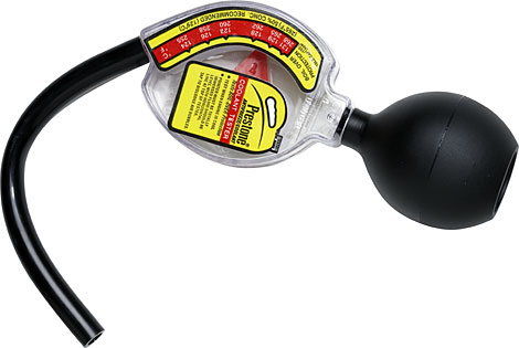

If you aren't sure if the anti freeze is premix or pure, purchase an Antifreeze Hydrometer. Very cheap at any auto store. Premix will usually read -37C or -34F.
