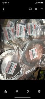

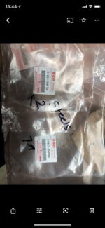

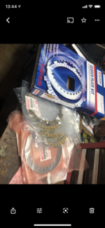

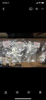

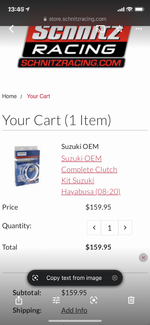

I bought a kit from schnitz racing, the suzuki kit has the fibers and steels, set up for judder springs, but it has springs and a gasket i just gave to my tuner as i dont know about the busa springs. Schnitz sells different sets with just fibers (KG is the name and for busa) MTC engineering also has fibers for us and barnett, some rocketeers do away with the judder springs and put in a regular fiber in its place of the small fiber and judder springs https://store.schnitzracing.com/suzuki-oem-complete-clutch-kit-suzuki-hayabusa-08-20/
Many thanks. Very helpful 👍:)
