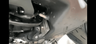

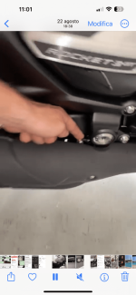

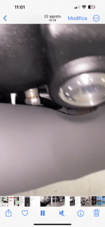

Two 02 sensors exhaust
So now all who think my bike haven’t 2 o2 sensors maybe think to wait before write…
It makes sense to supply North American markets with the less costly emission models than the stringent euro 5+ standards with two sensors. Got to use up those old parts.
I hate this two sensors model because of no pipes available
I definitely don’t have the 2nd sensor located on the Cat. So looks like USA models won’t have it.
