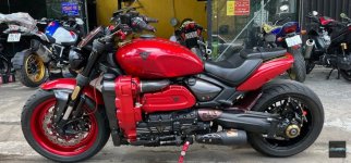

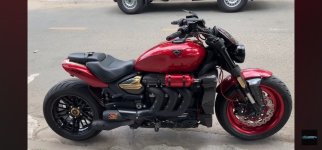

Has anyone else thought about this, or tried something similar? The closest thing I have found is the 3-into-3 Patriot from Dave Platt Exhausts (dot com). Here are a few pictures of that system. The thing this adds is a single "box" collector, with 3 pipes coming out of it. I prefer the "straight pipe" look of the Competition Werkes over this, but I still want the 3rd exit. Maybe I want too many things.
