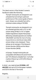

Here is Triumphs response.
I think one just goes by Ron if in other Country than US. In US, AKI label on the pump is what we use, so 87 octane.
I did send follow up saying many sites show conversion of Ron 95 = 91 aki. Curious the answer. Wonder if in other Countries guys/gals going to the pump with Ron label saying " but 87 aki means we should be using Ron 91, not 95"!!!!!!

The US versions are allowed up to 15%. Most places run only up to 10%, the max they can run will be on the fuel pump. There is no minimum so it might say 15% on the pump but it can be from 0-15% and as you mentioned the mix changes through the year and by region.
I took the salesman's statement to use 91 octane without verifying myself on both this bike and my 2017 honda accord. After seeing this post, I also checked the Honda. Nope, 87. Both vehicles. Should know to always verify.
Don't have a problem paying less and possibly better performance. Will check mileage now and compare.
