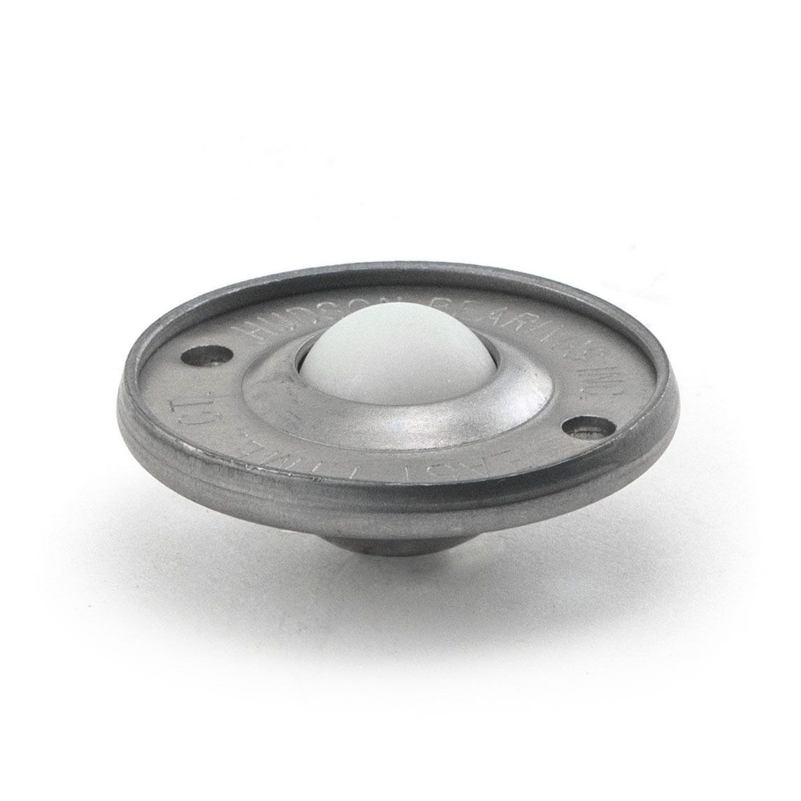

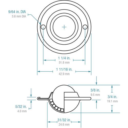

What about fitting some low profile flange type casters under the unit similar to this... Many sizes.
Hudson Bearings 5/8" Nylon Ball Carbon Steel Low Profile Flying Saucer Ball Transfer NFSBT-5/8CS
Actually...I bought 4 very similar items but decided not to use them. Very low profile, but I did not want it moving around in any way once moved into position. I figured the movement would be one more thing I would be fighting with. If I would have used them, I was going to put 4 threaded bolts located on each corner that I could turn down to rest on my garage floor to keep things from moving.
