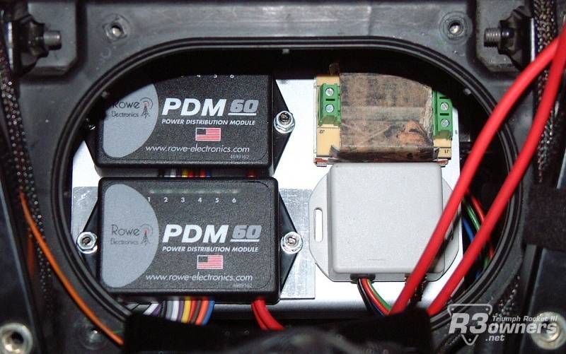

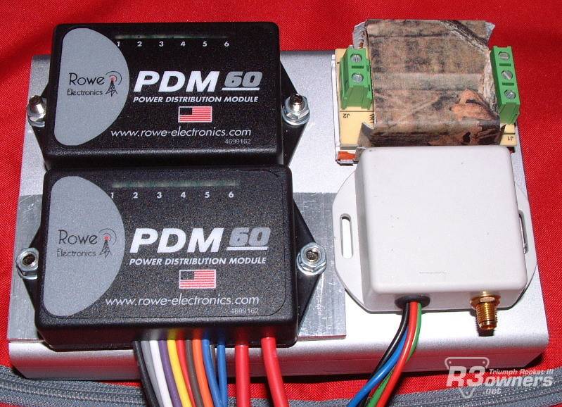

So here is my "module" - I'm not at the wire stage yet.
Once persuaded gently into filter box (wires obviously not yet routed!)
The earth bus is underneath - all the connectors will be inside the box section.
Well - that's the plan. The box bit btw - is a cut down 3.5" USB-HDD case.
The white box is a GPS speed sensor and the other thing will be to activate IGN trigger on one PDM60 only when the alternator charges. Engine not running - lights off. The other will have normal ign trigger as it has the PCV-AT on. Delays will be used on both for most circuits. Though different on each PDM. Most circuits will actually pass very little current - lights are all LED and have relays elsewhere.
