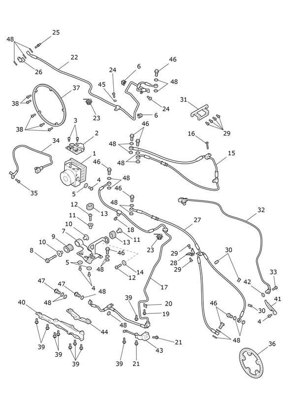

OK, this is interesting.... If you look on Hermy's Triumph Parts there are a few parts in the diagram that are not listed for purchase. Why?
#12 - just a bolt, weird
#23 - what the hell is that?
#34 - is a short brake line. Rear master to ABS, maybe? Issue here? Why not for sale?
