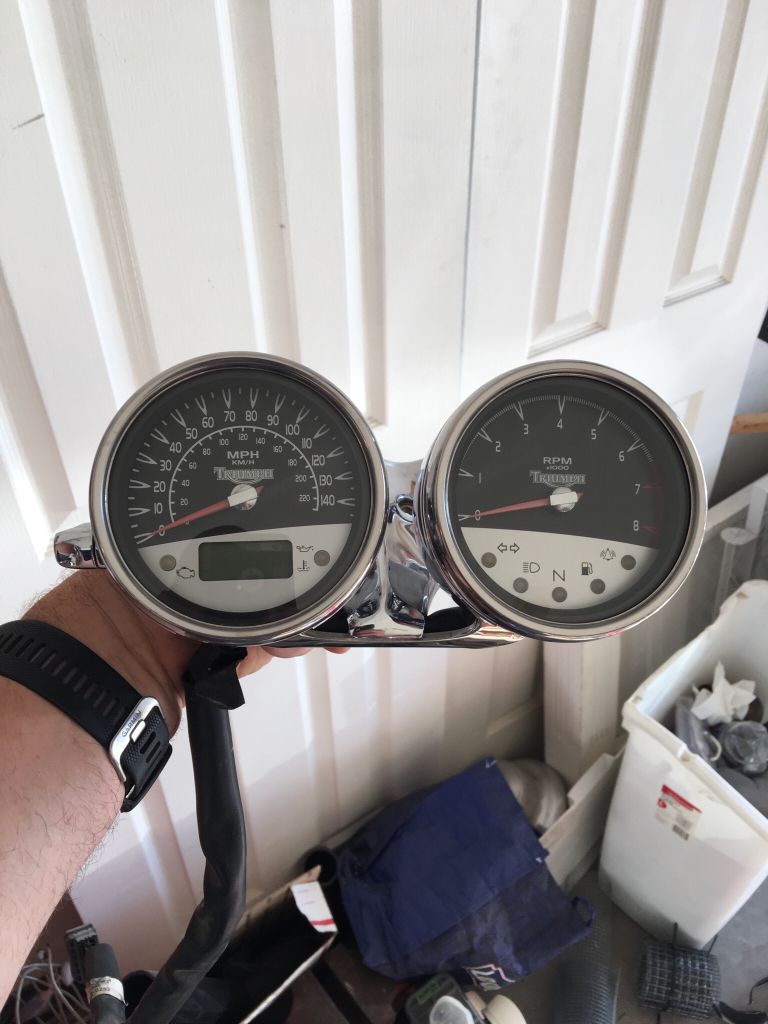

No start at all, not even a relay click. On the plus side, I just won an auction on eBay for a speedo and tach combo in perfect condition off a 2005 Classic for $153. I should have them within 2-3 days.

LOL. New gauge set, same problem. Started hunting. One of the 30-amp battery fuses had blown. [emoji849] Anybody need an almost-perfect 2005 speedo & tach set? $200 & free shipping for my R3 kin.
