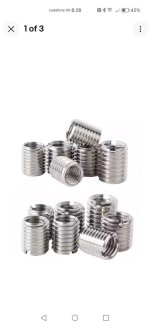

If the M6 thread is ruined I recommend this type of thread reducer
I've used them in alloy many times over the years with great success
Tap out the hole to M8 and screw it in with thread locking compound and you have a strong steel M6 thread
