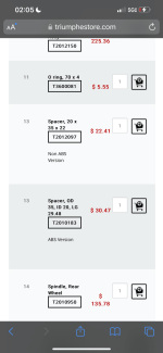

Kevin frazier Widowmaker! Joined Dec 22, 2018 Messages 7,676 Location Nashville Ride 2008 Triumph rocket 3 touring Feb 13, 2024 #2 Inner axel spacer? If youre referring to #13 yes there is a difference Attachments IMG_1275.jpeg 50.5 KB · Views: 18 IMG_1274.png 27.8 KB · Views: 23

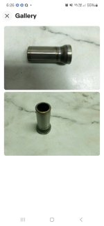

Troy Watson Standard Bore Joined Feb 6, 2019 Messages 9 Ride Rocket 3 classic 2007 Feb 13, 2024 #3 Kevin frazier said: Inner axel spacer? If youre referring to #13 yes there is a difference Click to expand... Thanks Kevin but I am referring to the spacer in the final drive which the rear wheel bearing are torqued up to when you tighten the rear axel Attachments Screenshot_20240213_182617_eBay.jpg 43.2 KB · Views: 13
