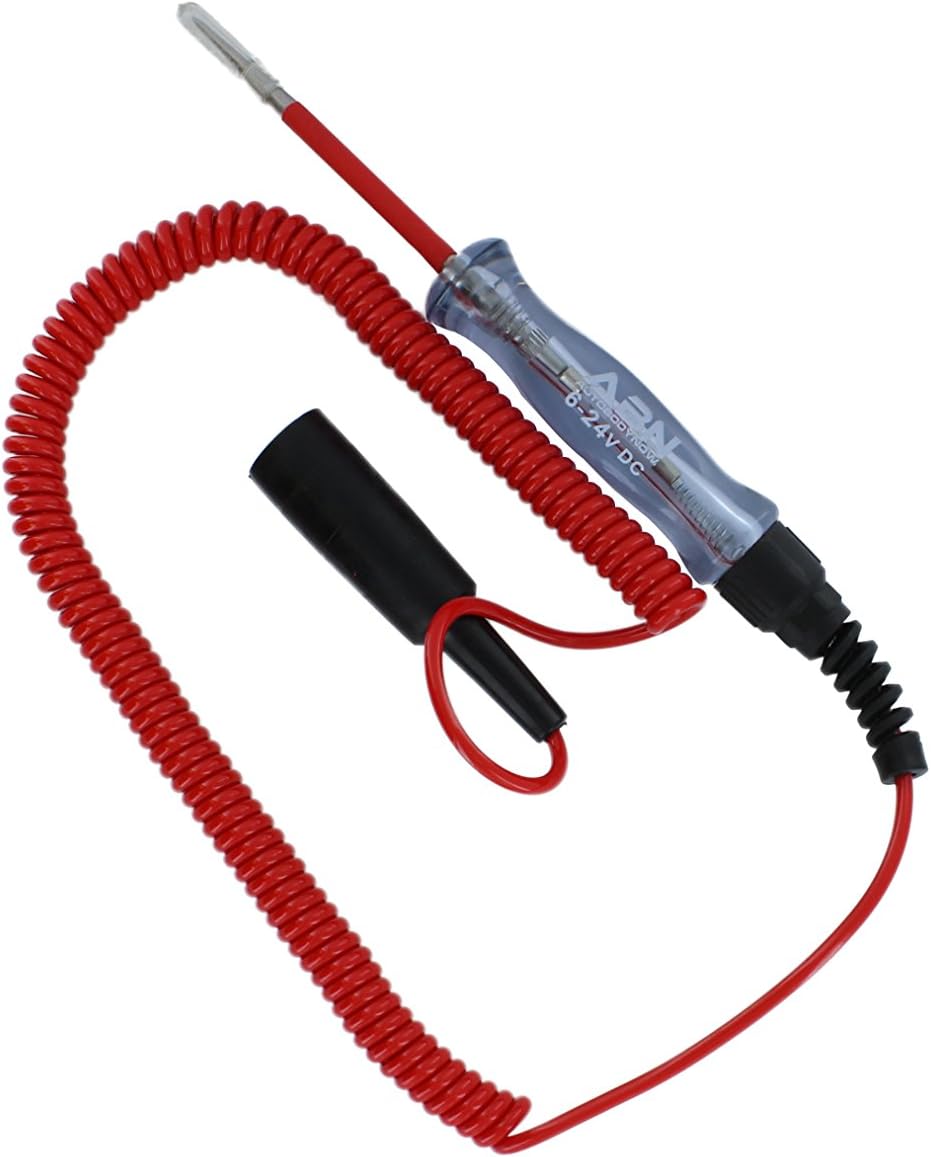

u need to buy a 12 volt test light.
with the 12 volt test light u can test for 12 volts at the clutch switch to see if i am right or wrong
u can also check if u have a ground at the clutch switch.
u get the tester and someone will tell u how to hook it up.

In regards to the test light : I do have a pen like one just not sure if good enough or should I buy one with an extra cable and clamp attached?
