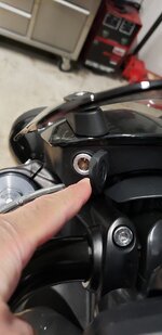

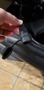

I want to get rid of the battery tender wire that comes from the battery leads and hangs down just below the seat. My question is, can I use the Triumph auxiliary socket located up by the windshield on the 2022 GT to charge the battery. If so, do I wire up an adapter to my battery tender or do they make such a thing.

The socket by the windscreen is hot only when the electrical system is turned on. The best solution is to purchased the additional socket which installs below the intake and plugs into the provided always hot wire behind the socket location. Very easy and cheap to install and works really well.
I have my battery tender wire come down into the passenger right side foot peg area directly behind it. You can't see it when the peg is up as it's hiding behind it and it's also short enough that it wouldn't interfere with a passenger using the pegs. Works well for me.:thumbsup:
