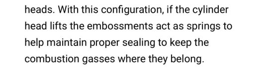

There are 2 versions of the head gasket available, there's a pic there that illustrates the differences, I wonder was this Threebond thing only there for the older style gasket or why would they update the gasket.
Mind you I've used both gaskets and no probs and not used Threebond there.
You'd wonder why the old gasket is still available, the new improved one is fully compatible with all engines afaik.
Wow. That's a new one. Wonder did they decide to start including Threebond on head gaskets after several years of barebacking it?
This is the head gasket comparison of the 2 versions available;
...........................T1151150.................................................................T1150189..............................

The book with the threebond must be for the old gasket without the embossed areas that act as a spring if head lifts. Thanks R-111-R for help clearing that up, moving on
