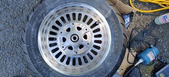

Researched aluminum polish for the rims and found Gords on YouTube, looks like the easiest way, going to have to take the wheels off and rotors, got a lot of buffing pads and the 0000 steel wool and red shop rags, going to try to get them to shine they're just dull right now with some black spots here and there I will post a before and after shot, hopefully get to it next week. 👌

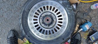

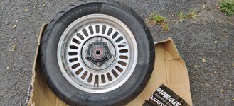

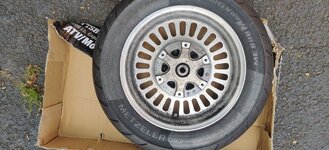

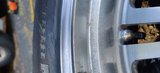

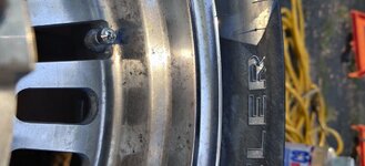

I polished the back rim today, started about 2 in the afternoon and finished about 5:30, - 1 hr break in-between, so it took me 2.5 hrs just to polish the 1 wheel not counting removing it, that took about 2 hrs cause I stripped 1 of the hex head bolt for the brake disk to get it off, luckily it was out enough to cut the edges off 2 sides and get a 12mm wrench on it, now I have to find a new bolt, hope they aren't discontinued, 1 website said they are, and another says they are available, but that doesn't always mean they are available I found out with the windscreen lock, discontinued can't get it anywhere, not even a used one.
Well I think Gords aluminum polish did fairly good, not perfect, it still has some faint spots I'm sure I could have gotten out with some wet sand paper, maybe start with 1000 grit and work down to 6000, would probably make it perfect, but I was done for the day, maybe I'll stop tonight and get some, I didn't have any, but here's what it looks like after 2 to 3 hrs.
A very big difference, I used these buffing Wheels I got on Amazon, Car Buffers and Polishers Kit for Drill, 14Pcs Drill Polishing Wheel Foam Ball Buffing Pads Sponge Ball for Automotive Car Wheels Hub Care, Metal, Plastic, Ceramic and Glass worked very good, perfect size, probably should have used them from the beginning, I used a cordless drill driver with them, I started with the 0000 steel wool, wet the wheel with the soaked steel wool, let it soak for a few minutes, and rub the heavy corrosion off. Then clean it with the shop towels after it dries, at least that's what I did, a few times then I used the buffing Wheels, I even used a Dremel type tool to get in the holes. GL hope it lasts a long long time 🤣

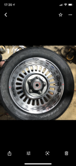

What did you use?? How long did it take??
Sand paper, whatever takes off the finish, 300 maybe then 500 then 700 you will see your scratches change as you go up, i had to go about 2500 i think and now its just 0000(4) steel wool and i use some polish from Germany aerosol maybe but with 0000 steel wool you really need nothing, just wash dry hit with 0000 steel wool wipe buff clean and its back to mirror finish like after the sanding, oh how long, felt like two weeks a couple hours a day, painful but worth it because now im always fresh and clean :cool:
