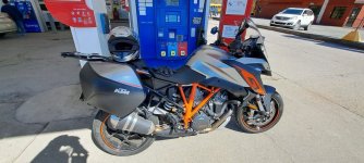

Same here. I either look for a slight depression for the sidestand or a high spot for the front wheel. I'm used to doing that from my KTM 1290 SDR wich had a long sidestand and was very light. Sometimes it looked vertical and I could see it swaying in the wind. I also tried to park with the wind blowing the bike onto the stand, not the other way round.
I've noticed a lot of bikes these days, especially sports bikes, have long stands and sit very upright.
Gimlet, I had a '19 KTM 1290 SD GT and loved it. Good times.
