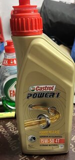

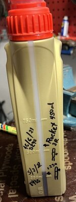

Hi from Zaragoza Spain,
I'm very happy with this Bike (not my wife she only like to see it), a funny bike:p, only I see 2 issues: she like to drink too much fuel, little of engine-oil also like 90ml each 1000Kms, now 9K5 Kms in one year now she need new back tire.
About mech and electronics I like no problems for the moment, I bought it in 2021 January New. :thumbsup:
